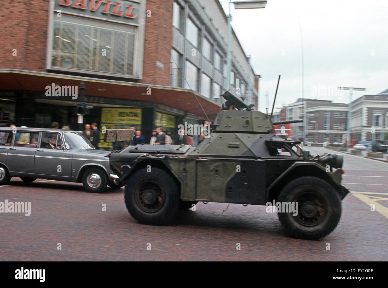

    (The long, angled peice of metal on this Ferret’s turret front was for cutting wires and obstructions before they removed the commanders ability to think)
